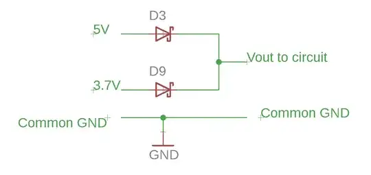

You can use a basic diode switch like this:
schematic
When 5 V is present, no current will flow from the 3.7 V source.

    0.6 volts (the drop across the active forward-bias diode) out of 3.7v (or outa 5v) is a significant portion. you might have to accept 15% power loss or, at best, 85% efficiency. – robert bristow-johnson Jul 31 '18 at 21:26
  • @Robert The O.P. wanted teh simplest [sic]. A 15% hit on efficiency is a fair price for simplicity in many cases. – Nick Alexeev Aug 01 '18 at 15:59
