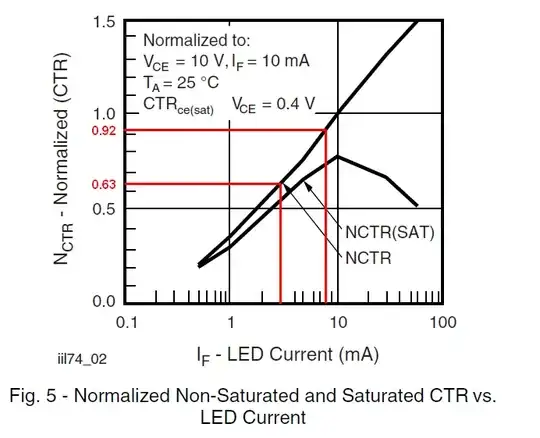

Also to consider is the CTR for a typical device as its LED current varies: -
So if you could drive an LED at 8 mA, the typical CTR would mean that the output transistor would conduct with 0.92 x 8 mA i.e. 7.36 mA. At one-quarter drive, the CTR is typically only 0.63 and hence the collector current would be 1.26 mA.
Using a shared resistor could mean a variation in collector current of 1.26 mA to 7.36 mA = 5.8 to 1. Only you can say if your design can cope with this as well as coping with the potential for a 12:1 CTR between respective devices in the same package.
