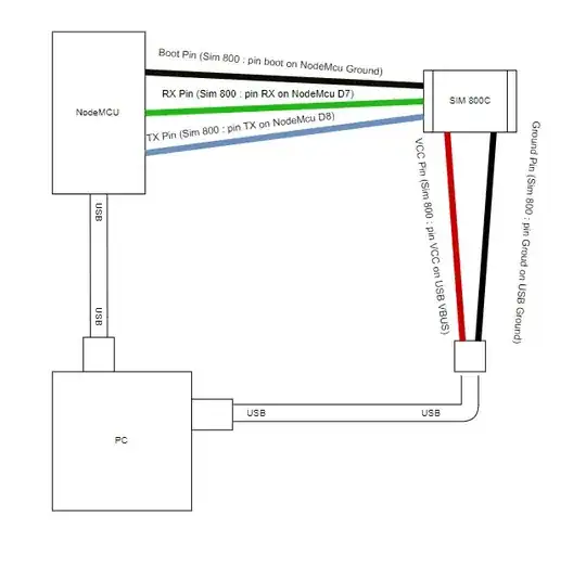

To sum up what works and what doesn't, I'll link two schemas, one is a "working" one and the other isn't.
Below is the working one :
Working schema
And then, the non-working one :

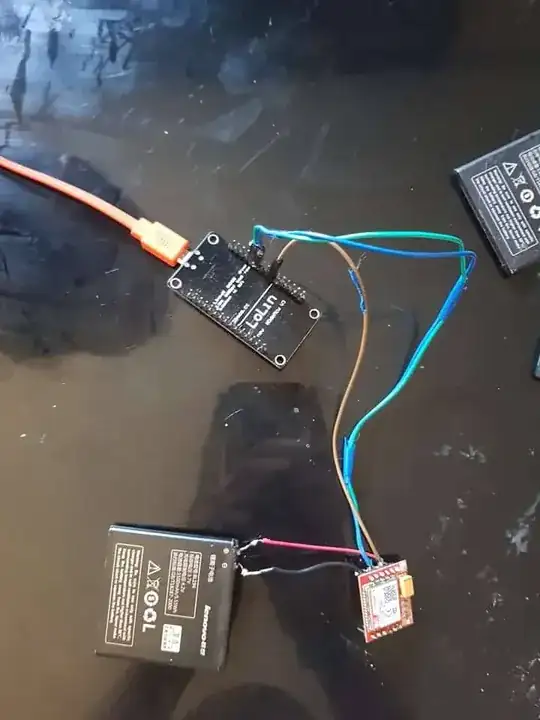

Edit: Here is a photo of the montage. We can see the NodeMCU being powered by USB in the center, the battery in the bottom left as well as the GSM Module (SIM800C) in the bottom right of the picture.

Have you ensured that there is a shared ground between the SIM800 module and the NodeMCU module? In your first example this common ground would be provided by being connected to the PC over the USB connections but in your second schematic there doesn't appear to be a connection.
Even though you have the NodeMCU GND pin connected to the BOOT pin on the SIM800 you should provide a dedicated ground to make sure that everything shares the same point of reference.

  • If you add a link or photograph of your current setup that might help. – anonymous Jul 25 '18 at 15:12

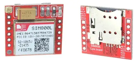

I suspect there is a case of mistaken pinout here. To be absolutely sure it would be helpful if you post high resolution photos of both sides of your SIM800C board.
When I search for these modules on web most of them look just like yours:

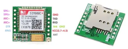

Note that pin next to VCC is called "RST", which is "reset". There are also boards that look like this:
The pinout is identical, only the pin is called "BOOT". However the text in the picture says "link GND".
I suspect this is what caused the confusion. In both cases this pin is connected to PWRKEY input on SIM800C. Here is what the description says:
PWRKEY should be pulled low at least 1 second and then released to power on/down module.
I guess this is what whoever made that picture meant under "link GND": "connect this pin to GND to establish the link". It did not mean "this is ground for link connection".

  • You need to add ground wire from NodeMCU ground to SIM800C GND pin.
  • You need to disconnect RST/BOOT pin from NodeMCU ground and connect it either to free NodeMCU GPIO pin or to this new common ground from step 1 via a button.
If you use a button you press it for 1 second to power on SIM800C. If you use GPIO pin then in your code you have to output "0" for 1 second, then make pin tri-state.
