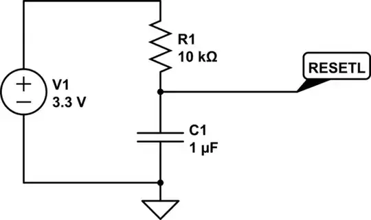

Just use an RC from +3.3V to GND with a time constant of ~10ms or so as shown below. The voltage on the cap should stay below threshold long enough to reset the part. This is a standard low cost way of implementing an active low power up reset, especially when the input already has hysteresis.
schematic
crj11

  • Hi. Thank you for your answer. What benefits would a voltage supervisor have over using the RC that crj11 suggested? – JamesStewy Jul 25 '18 at 04:10
    The voltage supervisor will be more exact with its timing and generally not vary with temperature. The RC circuit depends both on the temperature of the capacitor and the threshold voltage of the ~RESET pin (which can vary considerably part to part and also by temperature). Also, some types of CMOS logic don't like slow edges (they will dissipate excessive power during the transition) and so an RC circuit wouldn't work very well in that case since it would be stressing the IC. – Los Frijoles Jul 25 '18 at 04:42
    Looking at the application schematic, they actually do use an RC circuit, so the TUSB2036 should work fine with that solution. – Los Frijoles Jul 25 '18 at 04:45
  • RC would fail under "brown-out" condition (partial loss of power, where all circuit parameters might become undefined at random), while the supervisor circuit will generate a perfect reset. The RC will only work if the hub is bus-powered, and likely fail if the hub is self-powered and brown-out happens.. – Ale..chenski Jul 25 '18 at 05:11
