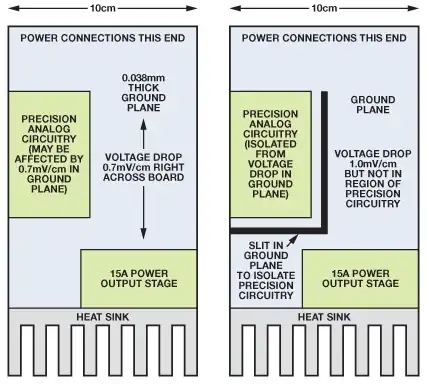

Another way to do it is with slots in the board:
Source: Staying well grounded
A problem with slots is they turn the PCB into a dipole antenna, and if the design needs to be FCC compliant, it may fail.
