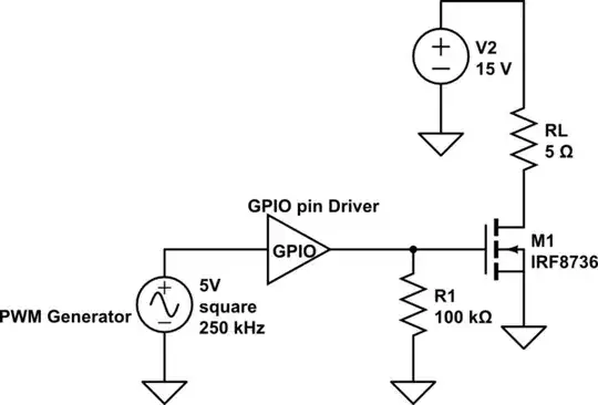

Suppose I have this circuit:
schematic
The datasheet for the IRF8736 states that the input capacitance (Ciss) is 2315pF @ Vds=15V (i.e. non-zero) and a gate resistance of 2.2Ohms, so the instant the GPIO signal goes high, the instantaneous current will be:
\$i = V / R\$
\$i = (Vdriver - Vgate) / Rgate\$
\$i = (5V - 0V) / 2.2Ohms\$
\$i = 2.27A\$
This is way larger than the 100mA maximum allowable current for the GPIO pin.
However, if we look at the power consumed by the driver to drive this signal:
\$Pdriver = Vgate * Qg * Fsw\$
\$Pdriver = 5V * 26nC * 250kHz\$
\$Pdriver = 32.5mW\$
Which is far below the total 800mW allowable by the MCU.
So in this particular case, which parameter should be followed to respect the limits of the MCU? The maximum allowable GPIO pin current, or the total allowable package dissipated power? I wish there was a total allowable power dissipation per GPIO.

I contacted a few silicon vendors about this question, and I got a variety of responses. The most enlightening answers read as follows (redacted/paraphrased for brevity):
[Vendor A]
The current limit called out in the datasheet is not the absolute maximum current allowed per pin but rather the maximum current for which the output voltage is guaranteed to meet the Voh/Vol specs. For higher currents the output voltage will be outside these limits but the output buffers will function properly.
[Vendor B]
The output buffers have their own output impedance which will limit the amount of current leaving the pin, even when directly shorted to VCC or GND. Therefore no adverse behaviors would occur from directly wiring a pin to a MOSFET gate as long as the power dissipation limits are met.
[Vendor C]
While it is good practice to add a series resistor between the pin and the MOSFET gate, it is not required to protect the output driver. Omitting the series resistor could however introduce a large current delta through GND, which could cause GND bounce.
[Vendor D]
The datasheet is specified for continuous currents rather than short instantaneous pulses, and so it is possible to exceed these limits without causing physical harm to the IC. However, providing guidelines for this operating condition is difficult and would need to be handled on a case-by-case basis.
In other words, it is most certainly possible to have GPIO pins source/sink higher currents for short pulses without damaging the drivers as long as the pin+package power dissipation limits are met. There's no free lunch, however, so proceed with caution.

  • You are correct, but in reality we regularly break this rule. For instance, turning on a MOSFET using a GPIO. When the MOSFET gate is discharged and the GPIO signal goes high, the is a small period of time where the instantaneous current will be very large, far higher than the maximum allowable GPIO pin current. At which point is the instantaneous current small enough to not damage the GPIO driver? – TRISAbits Jul 21 '18 at 17:05
  • It is good practice to place a small resistor between GPIO and MOSFET gate :) https://electronics.stackexchange.com/a/68754/81178 – filo Jul 21 '18 at 17:29
  • It's true, but so many designs don't include the series resistor for small signal FETs. – TRISAbits Jul 21 '18 at 19:10
  • You could make the argument that the small signal FETs inside a die don't have a series resistance either, so there's clearly a point at which the small instantaneous current is not dangerous to the FETs. At which point is the high current pulse high enough to warrant a series resistor? – TRISAbits Jul 21 '18 at 19:23
  • How does inductance of traces/pins etc effect this? – Szidor Jul 22 '18 at 06:48
  • The inductance would certainly help reduce the instantaneous current seen by the GPIO, but I imagine that within a die the trace inductance is very small (i.e. negligible), otherwise we wouldn't be able to get such high switching frequencies our of our fancy processors. – TRISAbits Jul 23 '18 at 03:38
