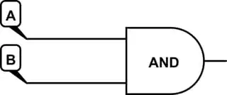

As Neil_UK showed in his answer, it can be a bit open for interpretation. He has covered pretty much everything, so I can only help further by allowing you to see it visually.
A lamp will light only if the following happens:
  • Switches A and B are both on.
  • Either Switch C or Switch D is on, but not both.
First let us look at the first condition:
  • Switches A and B are both on, but not both
schematic

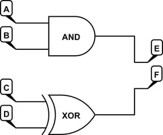

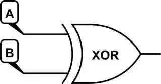

Now let us look at the second condition:
  • Either switch C or switch D is on, but not both
schematic
simulate this circuit
Great. We now have a circuit with 4 switches. But as you said, you now have 2 outputs. These can now be named E and F:
schematic

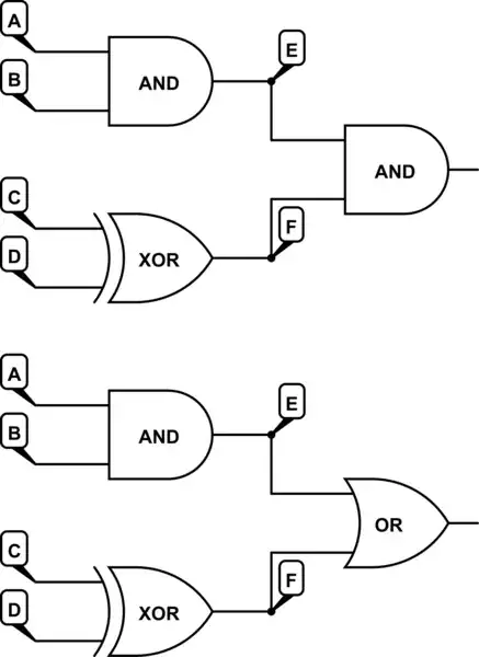

From here, it can get a bit open to interpretation, but you now have 2 choices. Did the question mean when both of these conditions exist? Meaning that A AND B, and C XOR D is the condition? Or did it mean A AND B, or C XOR D?
Let us look at your 2 possible circuits:
schematic
Now, looking at the wording:
To me, that sounds like it means the AND circuit is the one you want.
