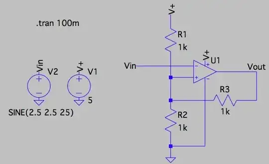

I am implementing a Schmitt trigger using the circuit shown below. This circuit consists of one LM741 op-amp, which acts as an asymmetrical Schmitt trigger with a single power supply. According to this calculator, choosing a 5 V supply and 1 k-ohm resistors for R1, R2, and RFB should result in a lower threshold of 1.66 V and an upper threshold of 3.33 V.

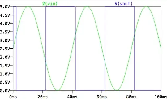

I first simulated this Schmitt trigger in LTspice with an ideal op-amp (universal op-amp 2). A circuit diagram is shown below.
This resulted in the ideal behavior in which the output saturates to positive or negative rail (ground) when the input falls below the lower threshold or rises above the upper threshold, respectively:

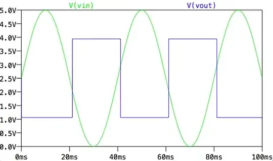

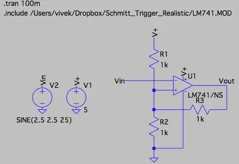

I next replaced the ideal op-amp with an LM741 (what I am using in practice) and re-ran the simulation. I got the LTspice model for the 741 from TI's website. The circuit diagram is shown below:
Upon running the simulation, I find that the op-amp is not able to saturate all the way up to the positive rail or down to the negative rail:

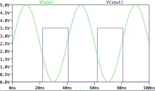

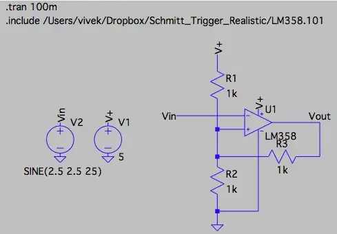

Edit: Upon seeing @Felthry's comment, I simulated the same circuit but with an LM358 instead of LM741 using the model found here. My circuit and result are shown below:

    741 won't work with a 5v supply. You need an absolute minimum of 10v, 15v would be better. Use a low voltage rail 2 rail amp if you want to work at 5v. – Neil_UK Jul 15 '18 at 20:17
    To answer your second question, the best solution is to just get a modern op-amp instead of using a design from the sixties. Try the LM358. Questions 1 and 3 require more explanation than I have time for right now, sorry. – Hearth Jul 15 '18 at 20:17
  • After you study the BJT Op Amp output swing due to current sinks and Emitter follower drops use the mean output to bias the R divider rather than V+/2 then consider that the Vpp is reduced then the feedback must accordingly increased. Whereas a CMOS OA is rail to rail. Just like 74HC14 – Tony Stewart EE75 Jul 15 '18 at 20:20

  • @Felthry, thank you for your comment. I edited my question to include simulation details with the LM358. While the lower rail does reach 0 V, the upper rail saturates at 3.5 V. Moreover, the trigger points of 1.69 V and 2.81 V do not match those calculated analytically (1.66 V and 3.33 V). Is there any way to remedy this? – Vivek Subramanian Jul 15 '18 at 22:00
  • @Vivek: Did you recalculate the switching points based on the 3.5 V maximum output? – Transistor Jul 15 '18 at 22:01
  • @Transistor, thanks for your comment. Please excuse my ignorance, but where do you see that the maximum output is 3.5 V? – Vivek Subramanian Jul 15 '18 at 22:28

  • @vivek: you reported 3.5 V max output in the comment before mine. It's also visible in your last graph. – Transistor Jul 15 '18 at 22:50
  • @Transistor, I was just interpreting the graph, but I expected the output to saturate at +5 V and at ground for the low and high cases, respectively. It’s not clear to me why it saturates at +3.5 Vand ground. – Vivek Subramanian Jul 15 '18 at 23:05

The National (now TI) LM741 really is not well characterized to run off of a single \$5\:\text{V}\$ supply rail. The LM741 datasheet suggests that with your loading, you are guaranteed to get within about \$3\:\text{V}\$ of each rail. The typical is better; within about \$1\:\text{V}\$ of each rail. But that's not the guarantee over their range of operation. So, a good argument can be made that the LM741 cannot be assured to work on a \$5\:\text{V}\$ rail.
That said, it's likely that you can make it work here.
To do so, though, I need to consider a way to make sure that a small excursion of the LM741 opamp's output is sufficient to drive something all the way to the rails. You may be able to get the output near \$1\:\text{V}\$, but I'd rather be conservative and figure no better than \$2\:\text{V}\$ above ground. You may also be able to get the output near \$4\:\text{V}\$, but I'd rather be conservative and figure no better than \$3\:\text{V}\$ above ground. Keep it as conservative as possible and work from there.
