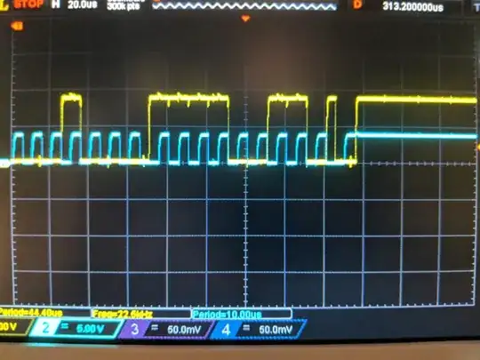

I'm trying to understand why placing resistors between Vcc and the data/clock lines helps my waveform be square, when I'm communicating between Arduino and an EEPROM chip. If resistors are not placed in the circuit, the waves look like shark fins. The circuit still functions, but they're definitely odd-looking waves.

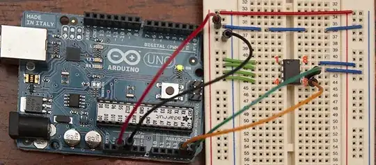

For background, this question arose after wiring up an Arduino to a Microchip 24LC256 (EEPROM) using I2C. Upon inspecting the signals with my oscilloscope (trying to debug something unrelated) I noticed the waves looked, well, horrible. They looked like shark fins to me (is there a more accepted EE phrase for this?). I checked several times to make sure my probe scopes were tuned/compensated correctly, and verified I didn't get such behavior on other circuits. This is what the wiring looked like:
Original wiring setup
Yellow signal is the SDA line and Blue is SCL

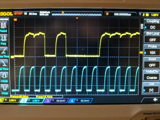

In a chance conversation I told an EE about this -- and they said this isn't uncommon for I2C. He recommended putting a 10k Ohm resistor between Vcc to SCL, and trying a lower resistor between Vcc and SDA. Additionally he recommended reducing the I2C speed to the lowest setting (31KHz for Uno). Sure enough if I put a 10k resistor between Vcc/SCL and a 4.7k resistor between Vcc/SDA -- they look nice and square. I also lowered the speed from normal down to 31KHz but that made a much smaller (if any) impact.
Unfortunately I never got a chance to ask why! I'm a noob to electronics but I'm very curious why a resistor placed like this causes them to be better looking square waves? This photo below is after using resistors, but before picking the 'optimal' resistor values for the best looking square waves. I think it looks much better.

You notice that on your scope measurement the outputs go low very quickly but are sluggish to rise to logic level 1.

If you really want to understand exactly what is happening it is likely that you are getting some kind of weak pull-up effect from a leakage current or possibly even an internal pullup resistor that is around 10 times larger than the I2C bus resistor should be. This causes that exponential RC rising waveform - the classic one of a capacitor charging through a resistor. With a proper value pull-up resistor it still happens, but quickly enough that the exponential looks vertical on the scope.
Whatever current source is bringing the line high in the absence of a true pull-up resistor, it is weak (ie, the circuit is very high-impedance) so it is also extreme susceptible to capacitive coupling from the clock line, hence you see the tops of the data line waveform showing artifacts when the clock switches.
