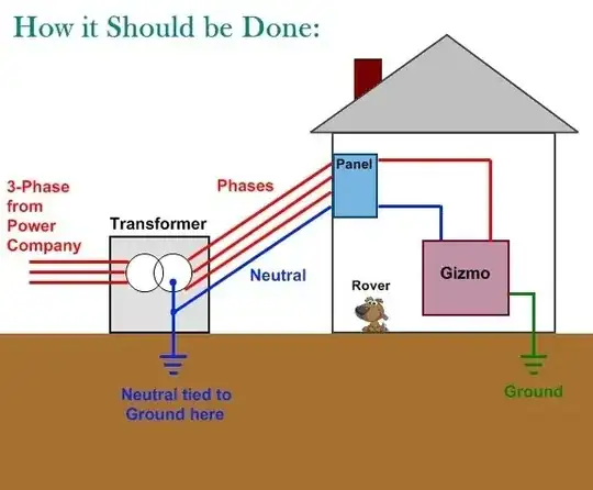

I understand the use of ground wire at the home appliances but why is the neutral wire connected to ground at the transformer? Why doesn't the neutral wire go back to the power generation plants.
I found this image online. I found this image online where this is done

    In order to save one overhead line. Look up Y-delta transformer. – winny Jul 10 '18 at 16:20
    Because the transformer provides separation of primary and secondary currents. – analogsystemsrf Jul 10 '18 at 16:22
    The image is incorrect and results in a dangerous configuration, The Ground spike is at the panel and Neutral is connected to ground at the panel. Neutral may be tied to ground at the transformer in addition, but not configured as the primary connection to ground. – Jack Creasey Jul 10 '18 at 16:27
    Ground does not need to go back to the power generation site since the supply is 3 phase Delta with no neutral. – Jack Creasey Jul 10 '18 at 16:29
  • @JackCreasey In many countries yes it should be a five wire system, but not all. Four wire systems does exist. – winny Jul 10 '18 at 16:34
    @JackCreasey That looks like a perfectly normal TT installation to me. If it was TN-S, there would be a separate ground line from the transformer. However, if it's TN-C-S, then the incoming neutral should be grounded. – Simon B Jul 10 '18 at 16:34
    @SimonB In the configuration shown you may have unbalanced current flowing in each phase so will develop a voltage difference between Neutral and Earth wiring. This is dangerous. – Jack Creasey Jul 10 '18 at 17:15
  • @JackCreasey It's the way we do it here in the UK. If it's a TT or TN-S supply, then the supplier doesn't ground the neutral at the customer's end, and the customer is prohibited from connecting them in their wiring. If it's a TN-C-S, then the ground and neutral are linked at the supplier's cut-out, and the customer may add an earth spike, but isn't required to (yet). – Simon B Jul 10 '18 at 22:44
    @SimonB As I understand it only TNC applies to low voltage house supplies. https://electrical-engineering-portal.com/erection-procedures-of-earthing-arrangements-tnc-tn-s-tnc-s-and-tt Yes there are other configurations, but not for houses. In TNC the conversion from 4 to five wire occurs in the entry panel so there will be minimized N/E potential differences. – Jack Creasey Jul 10 '18 at 23:11

The diagram you provided hints at this.
  • There is no connection between the three-phase, high voltage primary and the low-voltage secondary.
  • The supply is feeding a three-phase transformer without a neutral on the primary side.
  • The high-voltage network may be "floating" with no direct earth reference. This means that the distribution system can sustain a single earth fault on any one of its phases without causing an unplanned power interruption. This wouldn't be possible if the distribution system used a neutral as well.

No. The transformer is isolating. There is no connection between the primary and secondary so no current flows from the house back to the power station. As far as the house is concerned the local transformer is the "power station".

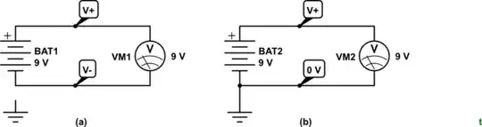

That doesn't make sense. If it's always at a potential then it can't be neutralised. Only if the supply would otherwise be floating can one of the conductors be neutralised. Let's look at a very simple example.
schematic
Figure 1. (a) A floating battery. (b) An earthed battery.
In (a) the battery is floating. There is no ground connection unless there is a fault and one of the wires touches something earthed. Then the other-wire becomes live.
In (b) the battery negative has been connected to earth. It is grounded or neutralised and the other wire is 9 V with respect to earth.
One of the advantages of neutralising is that no fuses are required in the neutral line as there is no significant voltage with respect to earth.
