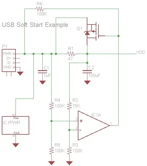

If I was designing a high power USB device then I would:
A. Live with the 10uF requirement, such as if I'm using a switching power supply or if my VDD is going to be 3.3V
or
B. Use a "soft start" circuit such as a 47 ohm resistor in series with my enormous bulk capacitor. Use a comparator to sense the voltage across the bulk capacitor. When the voltage is within 100mV of the USB bus voltage then have the comparator turn on a P-MOSFET that shorts the 47 ohm resistor.
USB soft start schematic

  • If you draw 100 mA the voltage across a 47 Ω resistor won't come even close to 100 mV, you would need a 1 Ω resistor then, but then you won't have a soft start anymore. And maybe you don't need comparator and FET, like when you would use the 5 V for an LDO regulator only. – stevenvh Aug 21 '12 at 05:16
  • I said "100mV" and then my circuit diagram shows more like 500mV. The voltage isn't the important part, it's more important to stay under the 100mA requirement when the bulk cap is charging. Sorry for the confusion. – Martin K Aug 21 '12 at 17:28
  • It's a good idea, but I think the voltage drop is important. If you switch the FET when there's still 500 mV to go C2 may still cause the kind of current peak the USB bus doesn't want to see in the first place. I would also add some hysteresis to that opamp (if it is an opamp, it doesn't say). – stevenvh Aug 21 '12 at 17:32
  • All good points. I meant it as a starting point for your own solution. – Martin K Aug 21 '12 at 18:21
