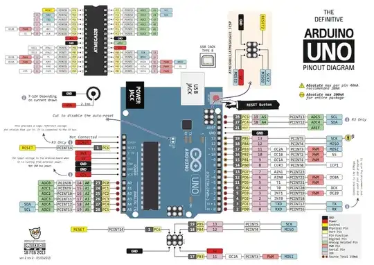

In the diagram, one can see that the SPI pins are shared with digital GPIO pins. Inside the Atmega328p die, are the two distinct elements/submodules with something like a buffer determining which will drive the pin? Or are they the same thing...
