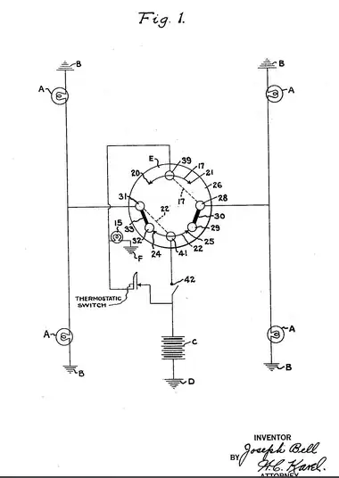

I don't think this is exactly what you were asking for, but just in case, turn signal flashers depend on this behavior.
From the 1933 Patent:
Turn signal patent circuit diagram
A thermostatic switch closes and opens the secondary circuit. When current flows a metal strip in the switch heats up, expands and eventually opens the circuit. When it cools down it shrinks and closes again.
Some modern ones (especially when low-current LED bulbs are used) are digital/solid state, but lots of cars still use the same exact principle.
Nick
  • 403
    Turn signals rely on the temperature change making and breaking a contact, not merely altering the resistance of a homogenous conductor. – Peter Green Jul 03 '18 at 12:03
  • True, though the flasher does depend on the current draw from the bulbs for the flash rate. – Nick Jul 03 '18 at 13:51
  • I suspect "bimetallic" might be more accurate than "metallic", but don't know for sure – Scott Seidman Jul 03 '18 at 23:36
