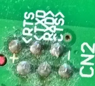

I try to label pins, pcbs, IC layouts, tables of connections, software, with the words IN/OUT and/or arrows showing the direction. Use the words "TX-out" "RX-in" "CTS-out" "RTS-in" on your schematics etc. This completely resolves the ambiguity. [I do generally think that TX and RX should be correctly named i.e. TX should be an output].
Here is a pcb where the signals cross an isolation barrier. Note the arrows, so someone debugging it, or trying to fit a connector clearly knows which ways the signals are going.

Sometimes both ways make sense at the same time: I have a chip where RX and TX are correctly named with their own function (from the chips perspective). But the handshake pins are named CTS and RTS matching the PC pins they will connect to, because this is what software and status lights refer to.

    You're showing RXD> with the arrow pointing away from the pin, which means that there is a signal coming out of that pin - I would certainly expect that to be an output, not an input! – pipe Jul 03 '18 at 15:15
  • @pipe If you consider where the chip is on the circuit board, relative to the connector, then it is not at all ambiguous to someone who is working on the product with no documentation. The arrow accurately represents signal flow. [interesting linguistic point: Unlike "out"/"in", arrows only have intrinsic meaning within a spatial context] – Henry Crun Jul 03 '18 at 21:20
