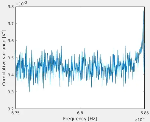

I do not know the exact value of the \$f_c\$ and want to estimate it from the input data, having an initial guess and refining the result by solving an optimization problem. My thinking is that I want the periodic sampling function \$g_p(t)\$ to select as similar data fragments as possible. Intuition suggests that we could look at the variance of \$x[n]\$:
$$ \text{Var}\left\{x[n]\right\} = \mathbb{E}_{g_p}\left\{x^2\right\} - \mathbb{E}_{g_p}\left\{x\right\}^2\\ \mathbb{E}_{g_p}\left\{a\right\} \stackrel{\text{def}}{=} \frac{1}{||g_p||}\int a(t) g_p(t) dt. $$
So far, this equation will give us a variance (a.k.a. measurement uncertainty) for a single sample of a receiver. I expect that this value should achieve its minimum if we've picked the correct \$f_c\$.
For stability reasons, I form the cost function as a combined variance from several samples. One sample will probably give a noisy result, and taking all samples requires too much computational effort.
Unfortunately, as I do a sweep over the search space, the cost function does not show any sort of convexity. Note that the initial guess is located in the middle of the X axis.
Cost function
Could anybody give me a hint about what I could possibly be doing wrong?

  • Post a link to your original sampled data, before you've 'done things' to it. – Neil_UK Jun 29 '18 at 10:57
  • added a screenshot from oscilloscope – skobls Jun 29 '18 at 11:03
    The search term should be ensemble averaging. Because you lack a good trigger here, this might not be easy. I suggest using periodogram techniques, like the Welch Periodogram, and then inverse transforming – Scott Seidman Jun 29 '18 at 13:36
