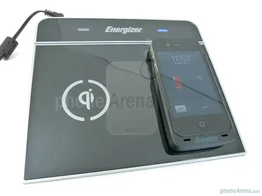

And in my cell phone:
qi phone
The method used in my devices is called Inductive Charging. I talk a bit more about it in my answer to this question. This is the most common and most practical form of transmitting energy wirelessly at the moment. But as many of the comments have noted, this is considered near field transmission. And with an effective range of only a few millimeters, it is very near field.

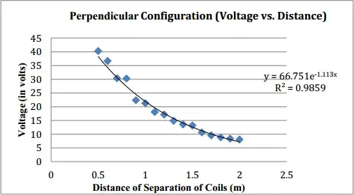

It's important to note that the distance between the transmitter and the receiver plays a crucial factor in determining how much energy can reliably be transferred. As can be seen in this paper based on the MIT project, the decay in voltage with respect to distance between the coils is exponential:
exponential decay

  • Is the law really exponential? I would have thought it would be an inverse-square law, like light, gravitation, etc. – user207421 Mar 29 '13 at 00:25
  • @EJP I wouldn't call that a law. Just the results of one experiment. The reality is, of course, a bit more complex. Since radio waves can be used to transmit power or data, have a look at the Friis Transmission Equation. The gains of the antennas and the wavelength/frequency also play a part. – embedded.kyle Mar 29 '13 at 12:30
