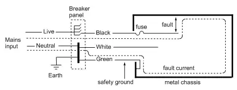

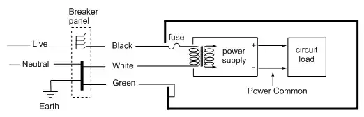

The ground is there to protect you in the case of a fault most circuits don't have a GFCI on them, if there is a fault the circuit can still protect you. First of all Electronic Test Labs (ETL) like UL require you to fuse your product if you have AC mains running into it (I think an exception to this may be if it's double insulated, but I'll have to check on that). The second thing that has to happen is you need a chassis connected to ground in your product so if there is a fault AC mains will ground out and trip the breaker (and the breaker doesn't need to be GFCI).
The second means of protection is a fuse that is also required in products by an ETL, this is set so it will blow in the event of a fault.
Another benefit of grounding the chassis, during a fault if the case of the product is touched, you will not get electrocuted. If you remove the ground in the system and there is a fault, you will get electrocuted.
Ground's aren't just a good idea, they are required in both homes and products to keep houses from burning down and people from getting electrocuted, the national codes and product requirements are there for a reason and work together for protection.
Normal Operation
Fault Operation

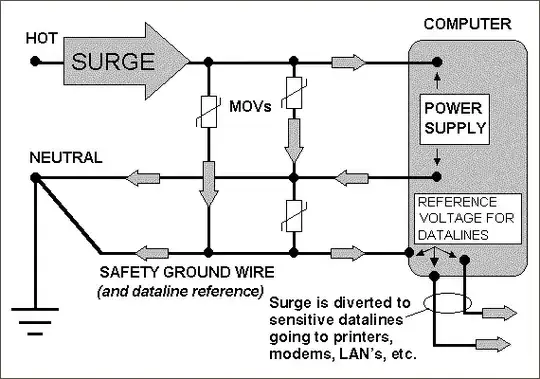

In the sense that the inspector was talking about equipment malfunction in the event the ground is disconnected, he was right. Some surge protectors use ground to shunt voltage spikes away from devices with metal oxide varistors. If the ground is disconnected the varistors will not be able to shunt high voltage spikes away from a device properly.
Source: https://zerosurge.com/surge-suppression/
Voltage Spike
