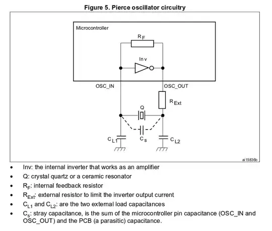

In some application notes, there is a recommendation to use an external resistor in series with the OSC_OUT pin to reduce the power dissipated by the crystal, if necessary to do so. A good example is from AN2867 STM32 oscillator design guide called "R_Ext".
Note there is never a resistor on the OSC_IN (EXTAL) leg in any application note and thus I never considered it for any transconductance calculation (Note 1).
So I've been a little bit thrown out by the S32K datasheet which explicitly shows an extra (internal) 280R resistor on the OSC_IN (the S32K calls the pin EXTAL) pin (p27, Figure 8):

The questions are about the 280-Ohm resistor on input. The picture clearly states that it is "ESD pad", and the value "280" likely represents the lump model for this pad cell.
  1. Does this "resistor" have any effect on the transconductance (gain margin) of the circuit design?
Yes, the resistor generally reduces overall gain of the amplifier (due to small parasitic cap on the internal inverter input), but the loss of gain is likely compensated in the inverter design.
  1. Is it likely to introduce any other effects that needs to get taken into account in the design?
Not really, see above.
  1. Would there ever be a reason to deliberately design in a resistor connected the inverter input?
This is just a model for ESD protection on the pin. Since the actual internal input impedance is likely in mega-Ohm range, the 280-Ohm shouldn't have much of impact. Even if the inverter input has 1 pF parasitic capacitance, the RC cut-off will be in ~3 Ghz area, or well outside the typical working frequency of 20-40 MHz
Therefore, the input resistor should be of no concern for the overall design.

    Thanks for the answer. I am trying to reconcile your answer with @Annie's answer. In your answer, you're suggesting the (280R) "resistor" will mostly affect the circuit due to the parasitic capacitance which is small in the grand scheme of things, rather than the effect of the resistance. Annie suggests that the "negative resistance" of the circuit and thus reduce the gain.
    Would the 280R be "seen" with respect to the amplifier being (more or less) high impedance?
    – Damien Jun 12 '18 at 00:11
    @Damien, the 280R is in series with input impedance of ~1 MOhm, adding 300R to 1M doesn't affect anything, other than small cut-off due to input gate parasitics. The R(Ext) is different, it is a part of overall feedback, part of C1-XTAL-C2 transformer (or whatever is is called when caps ratio defines voltage instead of winding ratio, and the R(Ext) is the resistor to worry about. – Ale..chenski Jun 12 '18 at 01:59

In your top diagram RExt does two things:
  1. It reduces the drive level seen by the crystal. Some small crystals are rated for low drive levels, and can be damaged by a 5 V square wave, for example.
    Note the description for RExt. It even says "RExt: external resistor to limit the inverter output current".
  2. It provides some guaranteed minimum impedance for CL2 to work against. Unlike what most references say, CL2 is not really a crystal "load" capacitor. Its job is to filter out some of the harmonic content coming from the inverter output.
    In the ideal case, the inverter output has 0 impedance. In that case, a capacitor on its output won't change the voltage at all. CL2 becomes irrelevant, and the crystal is always driven by the square wave out of the inverter.
    RExt and CL2 together form a low pass filter that attenuates the harmonics in the output of the inverter. After all, only the fundamental does anything useful. Crystals can vibrate at some harmonics. If the loop gain is over unity at any of these harmonics, then the whole oscillator might run at that frequency. In some cases, this effect is harnessed deliberately to run the crystal in "overtone" mode.
