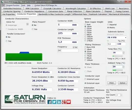

You can probably do this on a ceramic subtrate pcb. On normal FR4 you can do it, but the tolerance will be bad and the temperature coefficient will be horrible.
For 2.5A, and 0.1 Ohm you'd need 275mm of 1mm trace.
saturn pcb toolkit Saturn PCB toolkit.
However, I recommend a current sense resistor, or a hall effect sensor from Allegro MicroSystems or similar.
