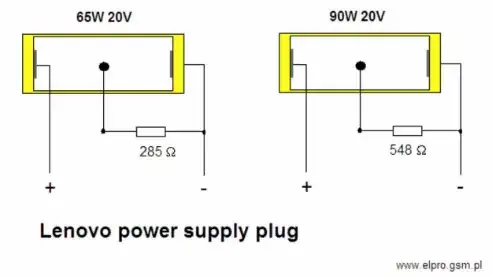

The problem arises in that many manufacturers protect the power supplies by adding a third pole to the connector to signal the power supply's rating to the laptop. There are various schemes such as a fixed voltage or a serial transmission over the extra wire to the laptop.
Figure 1. A random web image showing power connector pinout for Lenovo laptops using the yellow rectangular plug. The resistor, which is in the power supply, will be used by the laptop charging circuitry to determine the power capability of the PSU. If it meets or exceeds the power requirement of the laptop then charging will be enabled. Otherwise the laptop will run on "mains" only. Image source: Lenovo power supply plug configuration on YouTube.
