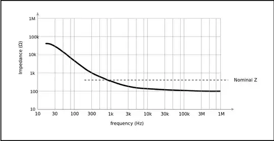

As frequency drops the characteristic impedance takes on a new form: -
Picture source.
At mid audio the two parameters that dominate are R and C hence Z0 becomes: -
$$\sqrt{\dfrac{R}{j\omega C}}$$
Notice the dotted line on the graph - this is at 600 ohms and it is the nominal impedance used by telephones to obtain what is known as minimal sidetone. Sidetone is not wanted - it's the audio you can hear in the earpiece when you speak into the microphone - this is needed to be low in telephony else it can become an annoyance and some signalling properties are reduced (DTMF dialling tones can be misinterpreted for instance).

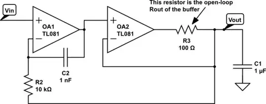

A buffer will not necessarily "fix" this, because capacitive loads will upset various buffers, depending on phase and gain behaviors.
But consider this
schematic
