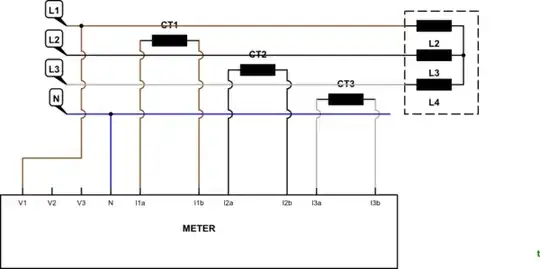

Given your lack of experience I would recommend that you purchase an industrial grade meter. These are available in fairly simple LED 7-segment display type up to full colour models as shown in Figure 2. The meter will give connection diagrams for the various CT and voltage probe wiring configurations. The meters typically give readings of

A point worth considering is that the meter has to be installed near the measuring point due to limits on the length of the CT wiring. If there is a possibility of connecting it to the building Ethernet you would have the option of remote monitoring and logging.
schematic
Figure 2. A likely wiring scheme for a 3-phase meter with one voltage connection.

  • I apologize. In the Figure 2 above, there is no potential transformer wiring. Does it not needed? – Tomato May 28 '18 at 13:28
  • Potential transformers are used to match the supply voltage to the instrument voltage. Most meters will accept 240/400 V directly. – Transistor May 28 '18 at 18:55
