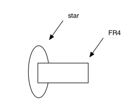

I am making my own LED bulbs (for wedge-base sockets in a low-voltage application). A key construction detail requires me to cement a small (roughly 3/8" x 1") piece of FR4 circuit board (which plugs into a wedge-base socket and holds a couple of small components) to an aluminum "star" (a thermal substrate for the LED emitter itself):
https://www.mouser.com/ProductDetail/Bergquist-Company/804087?qs=jQRjkUoUCJebprw0Kn9Vjw%3D%3D
The FR4 will be perpendicular to the star, with the narrow 3/8" edge of the FR4 against the back of the star.
The Osram Oslon SSL emitter will be running at up to a watt (but usually closer to 3/4). They will operate continuously for up to 10 hours at a time. The maximum spec'd junction temp is 135 C.
My question, what is the best method for making this attachment? I have tried JB Weld epoxy (two part), 100% silicon caulk (specifically GE clear Silicon II), and intend to experiment with Sugru. The epoxy is quite strong, but I have managed to break the connections when pulling bulbs out of sockets when they have gotten stuck. The silicon has the advantage of flexibility, but I don't think it's as strong; it's also easier to assemble, as it has enough stiffness to hold the FR4 in position while it cures, whereas the epoxy requires bracing. I've never worked with Sugru.
Are there other methods I might consider? Factors I haven't considered?

  • I do also think that edge gluing FR4 is not a good plan because there is not much surface area to work with. So you may want to rethink the whole approach. – user57037 May 27 '18 at 06:34
    @RustyShackleford correct. I was not suggesting PU for thermal bond but structural strength for CTE shear and warp forces. The silver epoxy only needs to fill the pits of non-coplanarity clamped to remove all air gaps so very thin. CPU use silver and ceramic filled grease under extremely flat surfaces with strong structural spring force to do the same. But here structural weakness is evident. – Tony Stewart EE75 May 27 '18 at 14:43
  • @mkeith, I am not just edge glueing (should've been clearer about that in OP), rather, there would be a cone-shaped fillet of adhesive, that is maybe 3/8" diameter on the back of the star and then comes up about 1/4" on the sides of the PCB – RustyShackleford May 27 '18 at 20:37

    There are tradeoffs and you may have to test several different solutions. Also, you need to examine how things fail. Did the bond fail right at the board/epoxy boundary or aluminum/epoxy boundary? If so, surface prep may solve the problem. If the epoxy failed (cracked in the middle of fillet), then you need to go to a stronger material (like aluminum). – user57037 May 27 '18 at 21:02
  • My failures with epoxy have been at the epoxy/aluminum boundary. The PCB has a lot more irregularity for the silicon to grip, and I will ultimately design my own PCB, so I can put in a big via hole, so there'd actually be a "bridge" of adhesive holding that bond. I haven't tried roughing up the aluminum yet (just cleaning and giving a quick pass with emery cloth). Again with my own PCB design, a little conductivity in the adhesive will not be a problem. The silicon really seems pretty strong, and I am leaning towards it. – RustyShackleford May 29 '18 at 03:45
  • If I did a small metal bracket as you suggest, I could of course screw it to my PCB design. I'd still have to cement it to the star aluminum. I'd have the advantage of similar materials, and a larger bonding area though. It would also help with the (lack of) thermal conductivity issue. – RustyShackleford May 29 '18 at 03:46
    Can you make a hole in the star for the FR4 to go through so that you could put a pin through the FR4 to secure it? – Andrew Morton Jun 17 '18 at 16:24
  • I don't think I can fit a hole that big (without disturbing the LED emitters and the traces to the pads for soldering leads), but a small hold might could be useful anyhow, to secure an L-shaped bracket, and forget adhesives altogether. – RustyShackleford Jun 17 '18 at 20:36
  • 5si years on. How did thse work out longer term? Which adhesive worked best? How many did you make? – Russell McMahon Apr 16 '23 at 11:17
  • @RussellMcMahon I ended up taking a piece of 3/8" aluminum angle and cutting 3/8" wide pieces off. Connected to PCB with a tiny sheet-metal screw and epoxy'd to the LED "star". A wee bit more work, but seems very reliable, plus the little piece of aluminum angle probably adds to the heat-sinking. I could use thermal epoxy, but doesn't seem necessary. I guess I've made about 50. – RustyShackleford Apr 16 '23 at 20:57
  • Of course the little aluminum bracket and the aluminum star have very similar thermal expansion, so that's good for the epoxy joint. And the other connection is a sheet-metal screw. – RustyShackleford Apr 17 '23 at 04:01
