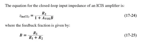

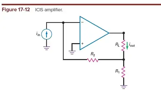

My textbook just gives the formulas w/o derivations and I've been trying to prove them when possible. But I feel stuck while calculating the input impedance of below ICIS amplifier.
My work :
Since almost all the input current goes through \$R_2\$ , voltage at the meeting point of the 3 resistors is given by \$-i_{in}R_2\$ .
Then the output current is given by $$ - i_{out} = i_{in} + \dfrac{i_{in} R_2}{R_1} $$
So the output voltage equals $$V_{out} = i_{out}R_L - i_{in}R_2$$
Also we have \$V_{out} = -A_{VOL}V_{-}\$
With some algebra to above 3 equation we get $$\dfrac{V_-}{i_{in}} = \dfrac{\left(1+\dfrac{R_2}{R_1}\right)R_L + R_2}{A_{VOL}} = \dfrac{\dfrac{\color{red}{R_L}}{B} + R_2}{A_{VOL}} $$
This is no where close to the given formula and I don't seem to simplify any further. Also I feel my work is wrong because \$\color{red}{R_L}\$ should not be there... Any help ?

I believe you have accidentally assumed that \$V_- = 0V\$ when you said
Since almost all the input current goes through \$R_2\$, voltage at the meeting point of the 3 resistors is given by \$−i_{in}R_2\$.
While it actually should be the voltage drop:
$$V_- - V_x = i_{in}R_2$$
You can still keep the equation
$$V_{out} = -A_{VOL}V_-$$
But the KCL at the crossing point (\$V_x\$) becomes:
$$i_{in} + \frac{V_{out} - V_x}{R_L} = \frac{V_x}{R_1}$$
This results in the expression

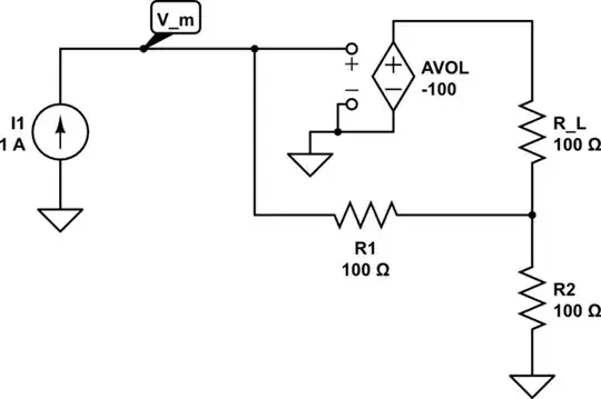

$$Z_{in} = \frac{V_-}{i_{in}} = \frac{(R_1 + R_2)R_L + R_1R_2}{R_L + (A_{VOL} + 1)R_1}$$
You can verify this formula by simulating the schematic below. I tried some combinations and I'm fairly certain that the input impedance is correct.
I haven't been able to get to the equation in your book though. I may need more information about their assumptions.
schematic

  • 25
  • ty :) that formula is from Electronic principles by Malvino. They must have approximated few things to arrive at that simple looking formula.. I'll move on for now, it is okay... this video has the exact same circuit https://1www.youtube.com/watch?v=a9kSibPi8yI @Sven B – AgentS May 25 '18 at 18:08
