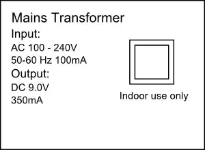

In addition to that, any modern device with a "figure 8" mains input (the female end of that cable you're showing) needs to have "double insulation" meaning it does not need an earth/ground connection. You can recognize "double insulation" from the symbol consisting of two squares:
Your new TV should have this symbol!
Note that there are also mains devices like toasters and computers which have 3-pin mains inputs. These devices do require the ground connection to make sure that the metal case is safe to touch.
Modern power supplies like the one in your TV do not care or even notice how you connect live and neutral so it does not matter how you connect them.
So you can safely use a non-polarized lead, the TV doesn't care at all assuming it is designed properly according to modern safety standards.

    5 Years old is still "modern" enough for my answer to apply. Only very old equipment (1980's and before) might not meet the modern safety standards. When in doubt, check for the logo, if it is there then "mains polarity" should not matter. – Bimpelrekkie May 22 '18 at 07:52
