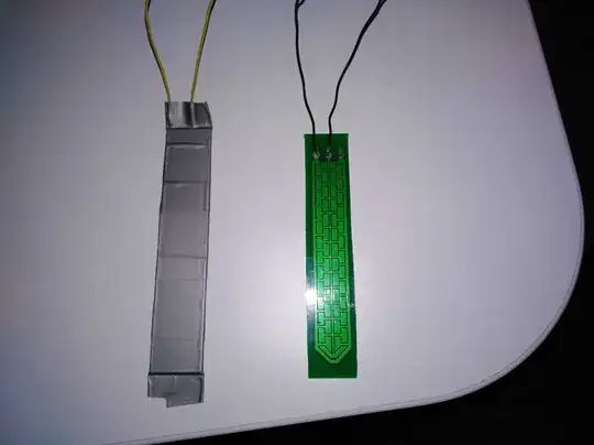

I have a piece of double sided PCB that I am plan to use a capacitor to measure soil moisture (somewhere between 133-170MHz).
Two prototype boards
I used the "two-pin method" of measuring small capacitance on the Arduino (calibrated against several values of ceramic capacitors between 2pF and 1nF).
Using the insulated board, I got the following results:
  • Air: 62pF
  • Hand grip: 26-27pF
  • Immersed 1/4 in water: 48pF
  • Immersed 1/2 in water: 60pF
  • Immersed 3/4 in water: 69pF
  • Immersed fully in water: 97pF
Questions
Firstly, why would the capacitance value initially decrease as the dielectric constant went from 1 (air) to >1 (my hand and partially submerged in water)?
Secondly, why would I only see such a small change when the board went from air (dielectric constant of 1) to fully immersed in water (dielectric constant of 80)? I accept that the leads from the boards will have some effect on the capacitance, but I doubt that they will have enough effect so as to swamp out the effect of water.

  • I suspect your measurement method is flawed. – Andy aka May 20 '18 at 13:46
  • The dielectric constant you mention for water is for water with no salts (distilled in other words). Ordinary tap water is definitely not without salts. See this question: https://chemistry.stackexchange.com/questions/16434/salt-concentration-and-electrical-permittivity-of-water – Peter Smith May 20 '18 at 13:49
  • Okay, from my old chemistry days sea water is approx 0.6 molar which from the graph in that answer would approximate to a constant of 70. We definitely don't have a problem with hard water where we live. – brendans-bits May 20 '18 at 14:01
  • Your hands are fairly lossy (resistive) which will have some effect on the measurement (depending on the measurement technique). Same would be true of salt water. –  May 20 '18 at 14:16
  • @BrianDrummond How could the resistivity of my hands affect the insulated board? – brendans-bits May 20 '18 at 14:19
  • @Andyaka I have no doubt that there is some margin of error in using the Arduino to perform time constant measurements, but I received fairly accurate readings with ceramic capacitors between 2pF and 1nF, so I suspect that the issue is related to the board, not the method. – brendans-bits May 20 '18 at 14:23
  • They won't affect the board, but they will affect electric fields external to the board - i.e. in the dielectric of your sensing capacitor. –  May 20 '18 at 14:23
  • @BrianDrummond I didn't know that. Thankyou. Does that mean that the 'ideal' dielectric is one that has high resistivity? – brendans-bits May 20 '18 at 14:27
  • @talikarng Absolutely. (Infinite is better than high). (Note the capacitance doesn't really decrease, the dielectric loss causes measurement error) –  May 20 '18 at 14:30
  • @BrianDrummond Thankyou, I learnt something new – brendans-bits May 20 '18 at 14:38
Your dielectric constant is roughly a geometric average of the PCB and solder mask constants and the outer medium's. To see the 80 fold increase, you need two parallel plates, not just parallel traces.
Lior Bilia
  • 7,560
  • 22
  • 31
  • I don't think that's how this product work. It has two parallel traces, the way you increase the capacitance is by placing a third plate (or something else that is conductive) that bridges the two parallel traces, forming two capacitors back to back. – Harry Svensson May 20 '18 at 14:26
  • @HarrySvensson Unfortunately parallel plates are not an option because this probe will be going into soil. I believe that I am relying on fringing capacitance. – brendans-bits May 20 '18 at 14:40
  • @talikarng The two parallel traces on the PCB is already there, that is what you got. That is not a part of the option. A third plate is the water, or something else, like moisture. I am not sure if it is "fringing capacitance". - If it looks like I'm saying something that doesn't add up, chances are I'm being misunderstood, which I think I've just been. – Harry Svensson May 20 '18 at 15:01
  • @HarrySvensson Now I understand what you mean. Thankyou. – brendans-bits May 20 '18 at 22:28
