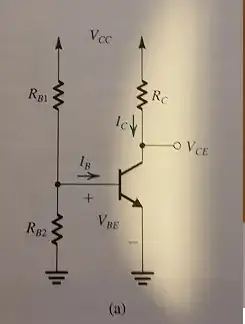

I am stuck solving the RB1 RB2 values in a classic discrete BJT circuit bias arrangement. I am sure its a simple thing that I am just not seeing.
Circuit values given are:

To start with simplifying things I have ignored VT and VA. I can determine Rth = (R2.R1)/R1+R2=R1||R2
and Vth=(R2.Vcc)/(R1+R2) = R2.10/(R1+R2).

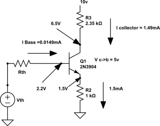

I can determine Ic=(100/101)(Ie)=1.49 mA and Ib=Ith=1.49 mA/100=0.0149 mA or 0.001 mA depending if I use KCL or ib=Ic/beta.
schematic
Now i apply KCL from ground through Vth, Rth, and out at base voltage = 2.2. and i end up with a ratios R1/R2=(7.8-IbR1)/2.2=(7.8-0.0149mAR1)/2.2.
From here i am stuck be cause i have 2 unknowns R1 and R2 and don't know any other equations i can apply to solve a value? I have also done a KCL at the RB1 RB2 BASE node and i end up with the same ratio. and i cannot substitute the KCL into the KVL because i end up with 0=0.
Suggestions?
Also what i have learned from making the KVL KVL substitution mistake is that you cannot substitute KVLs into other KVLs and KCLs because you end up with 0=0. is this always the case?

  • Your photo schematic doesn't match your circuitlab schematic. Is there a reason for that difference? – jonk May 19 '18 at 04:00

  • The photo was an example from the book. Sorry the worked question has a emmitter resistance. Yea as stated i said i was going to ignore early effect for simplicity – Alex Chala May 19 '18 at 04:11

From what I can see in your question, you really are missing a required element to solve for exact values. You need the base divider stiffness. Since you worked out the rest of the problem reasonably well from the givens, let's see what's left over.
You know \$I_\text{B}=\frac{I_\text{E}}{\beta+1}=\frac{1.5\:\text{mA}}{101}\approx 14.85\:\mu\text{A}\$. You also know the base voltage is \$V_\text{B}=2.2\:\text{V}\$. And finally, you know that \$V_\text{TH}-R_\text{TH}\cdot I_\text{B}=V_\text{B}\$. If you knew either of \$V_\text{TH}\$ or \$R_\text{TH}\$, you could solve for the remaining one. But your problem provides you no information here. You could pick a smaller value for \$R_\text{TH}\$ giving you a lower value for \$V_\text{TH}\$. Or you could pick a larger value for \$R_\text{TH}\$ giving you a higher value for \$V_\text{TH}\$.
In general, you want a smaller value for \$R_\text{TH}\$ for a number of reasons (except not too small, as that would waste a lot of excess current.) But a common rule is to set the biasing pair current to roughly one tenth of the collector/emitter current. (Or, as Brian mentions in his comment, ten times the base current -- which is about the same thing when \$\beta\approx 100\$.)
You know that \$V_\text{TH}=V_\text{CC}\frac{R_2}{R_1+R_2}\$ and \$R_\text{TH}=\frac{R_1\cdot R_2}{R_1+R_2}\$.
