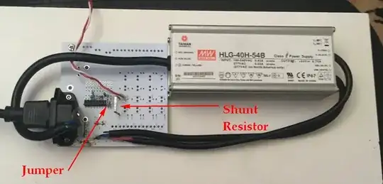

I would power them with a constant current Mean Well HLG driver. No fuse would be needed. I buy my HLG's from arrow.com because they have free shipping on 2 or more.
18 gauge wire is more than sufficient, meaning the wire voltage drop will be insignificant. When using a constant current driver any wire resistance has no affect on the LED current.
This is a 48V low current professional yet economical solution.

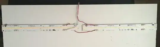

Cost of the Bridgelux is less than $4 per foot but provides 1,200 lumens per foot. You cannot come close to this cost per lumen with the 12V strips. I have a 100W fixture using the Bridgelux strips that provide a lot more light than the sunshine coming through my home's front window.
Here I am measuring the irradiance from seven Bridgelux 22" $7 strips ea. (P/N BXEB-L0560Z-35E2000-C-B3) for an horticulture application. Each strip outputs 2400 lumens.

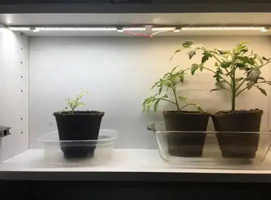

Below is an experiment with two $4 Bridgelux strips powered by a $28 Mean Well driver mounted to a shelf. This shows tomato plants like warm 3000K lights a lot more than 5700K cool white. All plants were germinated at the same time.
