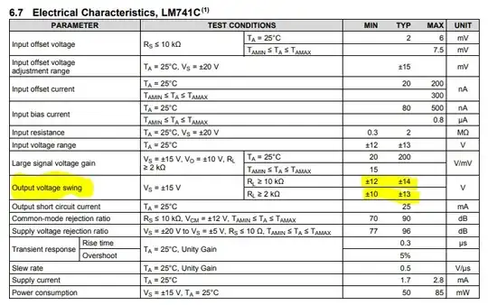

As pointed out by Bob in his answer, the datasheet says the guaranteed output is +/- 12V. Typically, it is +/- 14V, but this can depend on the load. The part of the datasheet you are looking for is here: enter image description here
All datasheets will have this Electrical Characteristics page. you just need to find the Output Voltage Swing. This will tell you how close it can get to the rails.

The 741 is generally not able to go from power rail to power rail, usually falling short by a couple volts.
Page 6 of the rev G data sheet shows this. For a +/-15v supply, the max guaranteed output is only +/-12v.
If you really need a wider swing, you need a different part, or a follower stage of some kind.
