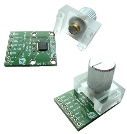

The best continuous rotation sensor I've used is the AMS series.
Something like this might suit your purpose. enter image description here
Of coursed they can't support infinite output values, but associated with an MCU you can set it to mid scale each time you turn your unit on, or remember last settings.
There are also plenty of relatively cheap optical encoders that would allow the same strategy of infinite rotation. For example, this from Bourns

  • An array of hall sensors is also a great solution to this problem. It might even be cheaper than the double sided pot solution, since it does not require an assembly on the bottom of the pcb – Busti May 13 '18 at 21:35
  • Unfortunately these require the knob or stem to be magnetic, which would increase manufacturing complexity. Usually the housing of a pot also serves as an anchor for the shaft, these would require the products casing to do that job. – Busti Jul 31 '20 at 23:53
  • @Busti magnetic 'po't replacements are available, as are incremental and absolute encoders. In the magnetic versions the pot shaft is NOT magnetic, the magnet is attached to the internal end of the shaft. https://tinyurl.com/yy66zp5j https://tinyurl.com/y593teum – Jack Creasey Aug 01 '20 at 16:11
  • @Jack_Creasy I would not have guessed that parts like that exist. Thanks a lot for the comment! – Busti Aug 01 '20 at 20:48
