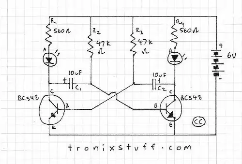

If you visit here there are instructions on how to do it with a 555, or here with capacitors and transistors: enter image description here

I believe what you are looking for is an astable multivibrator. At it's heart are just two capacitors and two transistors with a couple of resistors. wikipedia has an informative entry about it: http://en.wikipedia.org/wiki/Multivibrator
