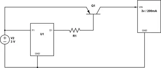

I have a uC (Arduino Mini) powered from 2xAA battery pack. The Mini display some data on a circuit with a MAX7219 + 2x7segments 4 digits led (a total of 8 numbers).
Because it is powered from battery (and for learning) I want to switch off the load totally when Arduino sleeps, and power on only when needed.
So, this is the very basic schematic (U1 the uC and U3 the load)
schematic
I know that for the high side switch I need a PNP, and with a PNP I need mantain GPIO HIGH (right?). But if Arduino sleeps, how it can mantain high?

    A couple of tips on schematic drawing: (1) With the CircuitLab tool you can save the editable schematic in your post. You don't need to take a screengrab. That way we can copy it into our answers and edit it. (2) Draw components with + at top. Your battery supply is upside down. (3) If you double-click on the Custom Component you can name the pins. (4) If the Arduino GPIO goes into tri-state (input mode) when going to sleep then you probably just need to add a pull-up resistor between Q1 base-emitter to keep it turned off. – Transistor May 04 '18 at 21:42
  • Just put a pullup :D – Andrés May 04 '18 at 21:42
  • @Transistor thank you for your CL hints... but... on free cannot save or share :( Ok, I did understand the necessity of pullup... but, for my others question? Can you help me? – sineverba May 04 '18 at 21:53
    When you use the CircuitLab button on the editor toolbar it's free. I might post an answer later. – Transistor May 04 '18 at 21:58
  • Added the Circuit Lab scheme. Thank you, w8 for your answers later :) – sineverba May 04 '18 at 22:03
  • @Transistor sorry for the "UP", looking also for your answer... Thank you :) – sineverba May 05 '18 at 15:29

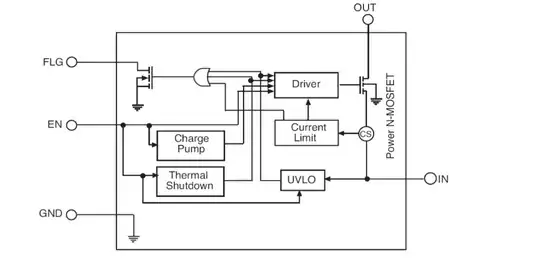

However, you don't need to invent new wheels. The device you are looking for is called "high-side" switch. There are many of them. Here is a typical device for you, SP2525A: enter image description here
The switch won't power your display until the EN is "high". So before enetering the Arduino sleep mode, turn the GPIO low. A pull-down resistor might help here.
