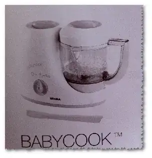

I bought for my baby this product from eBay:

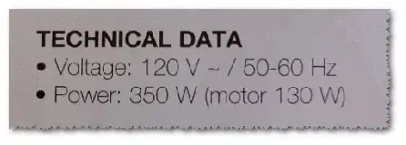

which has these technical data:

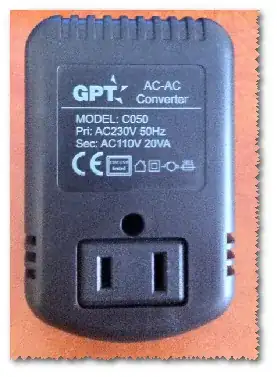

And so, I also bought (from Israel) this adapter:

Most likely the adapter. It's rated for 20 VA, which is about 20 W. The Babycook uses 350 W, that's 20 times as much. Pretty bad for the adapter. If it doesn't have any protection it's probably dead now. It may have overload protection, and then it would switch off soon after you switch the Babycook on. In any case it won't work, and I wouldn't try it either. You need a higher power adapter, or rather a 220V/110V transformer. 500 VA is not a luxe.
The adapter is, or was :-( a travel adapter for low-power devices like toothbrushes and shavers.
