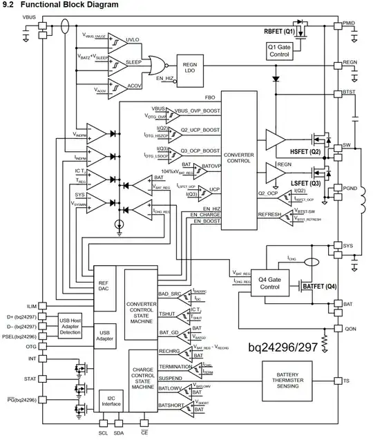

One typical line of intelligent chargers used in portable devices is produced by Texas Instruments (formerly Benchmarq), the BQ2xxxxx line. Here is an example of typical block-level architecture of the BQ24296 IC
Now you need to decide yourself what kind of engineering profess is needed to make this kind of circuit.

  • @ChrisStratton, actually, you are right, in the BQ24xxx PowerPath architecture, the switch between SYS and BAT remains closed if charger is in the middle of charging mode, so if SYS load exceeds capability of charger path, the difference is supplied from battery, instantly, no intervention is needed from SoC. – Ale..chenski Apr 30 '18 at 21:55
