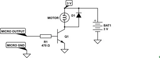

schematic
Figure 1. NPN motor control.
  • When the microcontroller output goes high a current will flow through R1 into the base of Q1.
  • The transistor will turn fully on and, effectively, connect the bottom of the motor to GND. (You could expect to see about 0.2 V drop across the transistor. The rest of the 3 V will be across the motor.)
  • When the micro output goes low the transistor will turn off.
  • D1 protects the transistor from any high-voltages generated by the inductance of the motor at the instant of turn off. It might not be essential with your low powered circuit but it is recommended.

  • I have updated the question. I tried to make the circuit you have given but the current that passed was too low, something like 1/5th of the needed. might be because of how the battery and motor are connected – Antariksha Yelkawar Apr 29 '18 at 15:13
  • Please explain how you know what current is needed and what current you got. The datasheet shows that the motor is rated for 1.5 V to 12 V. At 3 V you can expect 1/4 of rated speed at no load. That's 4000 / 4 = 1000 RPM. – Transistor Apr 29 '18 at 15:23
  • I measured the current while directly connected and when connected through the npn. they differ significantly – Antariksha Yelkawar Apr 30 '18 at 16:10
  • Use numbers rather than adjectives. – Transistor Apr 30 '18 at 18:06
