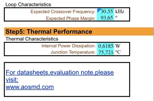

My input voltage is 7.4 and I need to step it down to 6.5 with a 3A current. I've used an xls file from the supplier to calculate the followin scheme: enter image description here

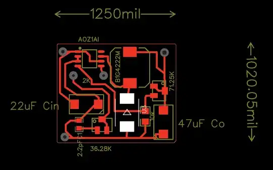

I might made some mistake in my PCB here:
But it doesn't work. It gives just 0,8V on Vout.
Here are the calculation results: enter image description here enter image description here

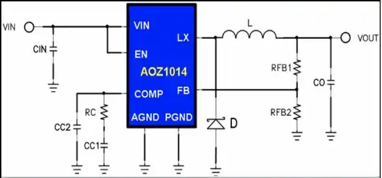

EDITED: I've read the circuit notes in the datasheet and done some changes. Do you think this circuit can work? enter image description here
    I'm not sure whether this would be enough to cause the regulator to fail, but that is a pretty bad layout for an SMPS. Take a look into app notes and eval kits, but in essence: keep switching loops small, power traces fat and short, key components (capacitors, inductors, diodes) should be carefully placed. – Wesley Lee Apr 28 '18 at 08:58
  • It is already tiny enough. I can’t imaging it is possible to make it shorter with chip pins placed this way. – Anton Zimin Apr 28 '18 at 09:03
  • The traces are long and thin. Tiny PCB != short traces. – Wesley Lee Apr 28 '18 at 09:17
  • Not sure it could give such a drop of voltage. – Anton Zimin Apr 28 '18 at 10:15
    It really could. You only need a fraction of a volt error on a feedback pin to completely mess up the regulation and protection circuitry. This explanation may help. https://electronics.stackexchange.com/questions/67894/use-of-ground-symbols-in-circuit-diagrams/67936#67936 A good way to re-lay out the board would be to use a 2-layer PCB with the entire second layer as a ground plane. –  Apr 28 '18 at 10:32
  • Seems it is a very sensitive chip. Even a touch can change the output voltage. Is it worth to use it with two servos as a step down dc-dc converter? – Anton Zimin Apr 28 '18 at 19:47
  • Please specify D. This better should be a fast recovery diode. – Janka Apr 28 '18 at 22:56
  • I have this one: http://www.farnell.com/datasheets/2119784.pdf – Anton Zimin Apr 28 '18 at 23:16
  • Thanks to everyone! You’ve been right. The way I’ve designed the first PCB is the cause. I’ve done it in a way I published later with wide and short traces and now it works just perfect. – Anton Zimin Apr 30 '18 at 01:35
I’ve made a new design for the board with fat traces and short loops and it works perfectly.
