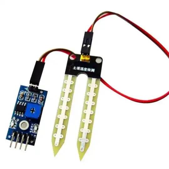

I want to get some measurements from a soil using a simple soil moisture sensor like this one: enter image description here
It has an analog output proportional to soil moisture.

The output impedance of the module's analog output is in the hundreds of K ohms (it's a voltage divider between a 510K resistor and the electrodes), so it's a relatively high impedance. You could buffer it (at the source) with an op-amp (eg. TSV912) as a voltage follower and add some series resistance (a few hundred ohms is fine) to keep the op-amp stable. So, two parts per module. You're really only using the 510K resistor in the module and a couple of capacitors if you ignore the DO.
That crude module puts DC (albeit limited to < 10uA with a 3.3V or 5V supply) through the electrodes, which isn't great. Higher moisture = lower voltage out. I wouldn't put too much faith in voltages read from this particular piece of kit.

The illustration appears identical to a board I possess. If this is the case, the IC is a LM393, set up as a comparator between the probe resistance and on-board components. The pot adjusts the trigger point. The output (labelled DO) is the comparator output, and is thus a GO/NOGO signal.
In other words, this does NOT produce an analogue signal. I think it is intended as a rapid indicator of insufficient moisture in the soil.
