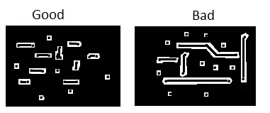

I think all these other answers are over-complicating the issue. Through-hole designs are legitimate in many cases, and so are 2 layer boards.
I would recommend using a ground plane and a signal/power plane unless you have a reason not to. This design method is tried and true and I don't see any reason you shouldn't use it. I think it doesn't really matter which side you put the signals on.
You will need to make some jumpers in the ground plane, but this won't cause any problems if you avoid making large cuts. I made a quick and terrible image in paint to illustrate:
ground plane large cuts vs jumpers illustration
As Neil mentioned, your ground return paths do matter, you shouldn't just consider them finished when they enter the ground plane.

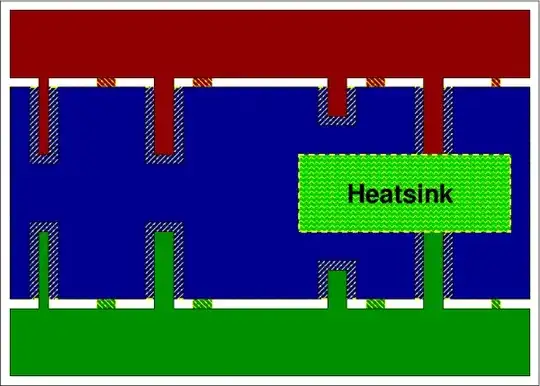

If you are wondering about ground planes, you have to forget through-hole! Having dedicated ground and power layers is all about maintaining low-impedance paths for all currents. Through-hole components have much additional impedance just from their bulky size and their wires.
If you want to stick to through-hole, I recommend a board that looks pretty much like the schematic. Use ground areas in both the middle of the top and the bottom layer. Use the long edges for V+ and V- paths. Create "copper fingers" from ground to V+/V- or vice versa to account for radial components. If your amplifier circuit needs three or four voltages, use the top layer for one voltage pair and the back layer for the other.
Please also remember, from AC view, V+, V- and GND are just the same. It's as important to have low impedance V+ and V- as GND.
The bottom ground fill is continous where the V+/V- fingers break the top one, and vice versa. Use the THT component's vias for the connection of the two GND fills. That way you give the through-holes a reason for existance. Use additional vias where required.
This is just the opposite from the board design a digital circuit needs. Now imagine the headaches of creating a mixed-signal board.

  • This is about having a dedicated ground plane vs. having a ground fill on both the top and the bottom layer. Clearly, the latter has lower internal resistance for the most prevalent currents between adjacent parts of the circuit (because it's two copper layers.) – Janka Apr 27 '18 at 18:13
