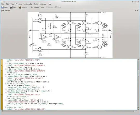

Try Cirkuit\$^1\$ together with Circuit Macros if you're into LaTex.
enter image description here \$^1\$ Reminds me of a Power Systems professor (I think he was from Romania) I had back in University, who would pronounce "circuit" as sare-kweet.
