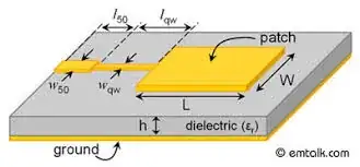

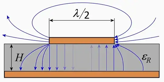

Consider also the "patch" antenna: -
It uses a ground plane and the top copper emits EM waves. It relies on the dimensions to the bottom ground plane and the width of the top copper to obtain resonance at just the right frequency. If that top-copper is surrounded by grounding copper then its effect is disrupted greatly.
