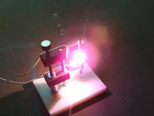

Carbon arc lamp is probably the most low-tech kind of bright electric light. You need only carbon rods (welding equipment or extracted from common zinc battery cells for example), large resistor and somewhat powerful power source. See for example description here.
Arc illustration
(Image from this site)
But be really careful if you try to reproduce this kind of light source yourself, it is quite dangerous for various reasons (fire danger, high voltage, production of strong UV light and noxious gases), see the warning in linked text too.

  • This looks like something doable. Do you know how powerful power source is required? Also how bright light can be? Is it comparable to lightbulbs? – Bobi Apr 14 '18 at 14:46
  • Carbon arc was used for anti aircraft searchlights in WW2, but you usually want two different sized carbons for best effect, and if you can get the copper coated ones normally used in old Cinema projectors you gain some useful efficiency. A few tens of volts at a few tens of amps is usually ballpark for a small one, going up to a few tens of volts at maybe 100A or so in a big unit. You will need to feed the carbons into the arc as they are slowly consumed, and watch the UV and reaction products, CO, CO2, NOx, Ozone, probably some buckyballs, none of it is exactly good for you. – Dan Mills Apr 16 '18 at 16:56

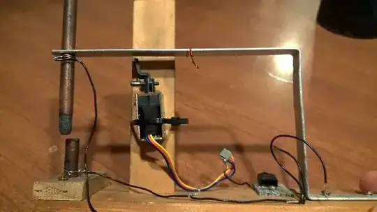

Yup Arc lights are the easiest by far. 2B pencil leads at a 2A bench power supply is quite adequate.
This was my kids at it. Actually at this point it has been turned into a spark transmitter.
Henry Crun
