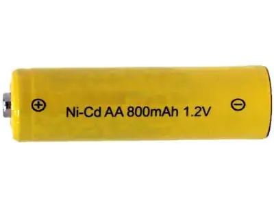

How quickly the battery charges depends on charging voltage. A typical Ni Cd rechargeable battery with total charge(Q) rating and voltage rating
Most trickle chargers charge the battery at 0.1Q. That is, at 80mA charge current, if we consider the cell in the picture. Generally it is possible to safely charge a Ni-Cd or Ni-MH battery using currents upto 1Q. (Maximum charge current would be 800mA for the cell in picture). Although you should avoid maximum charge current because not all manufacturers advice 1Q charge current.
What I would suggest you to do is to first consider the Q value on the cell you want to charge. The total charge content of the cell(Q) value is calculated by
Q=Ixt
where Q= total charge content of the cell(ideally) I= maximum current the cell can supply(ideally) t= time for which it can supply(ideally)
Q is always given on the cell in terms of mAh as seen in picture.
Grab a multimeter. Make a variable voltage source. You can build a simple voltage divider using variable resistors(POTs) and a simple 5v wall adapter/ cell phone charger. Set the output voltage of the voltage divider to 1.4V. Connect it to the cell. Measure the current. Increase the voltage suitably to increase the charge current. I would suggest 0.5Q to be safe(That would be 400mA for the cell in picture). This charge current would charge your cell in 2 hours! Make sure you disconnect the charger after 2 hours to avoid overheating the cell and possibly venting it(damaging it).
