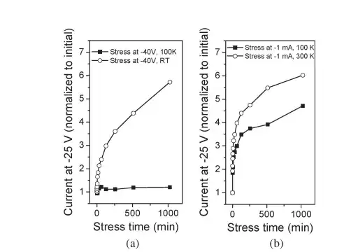

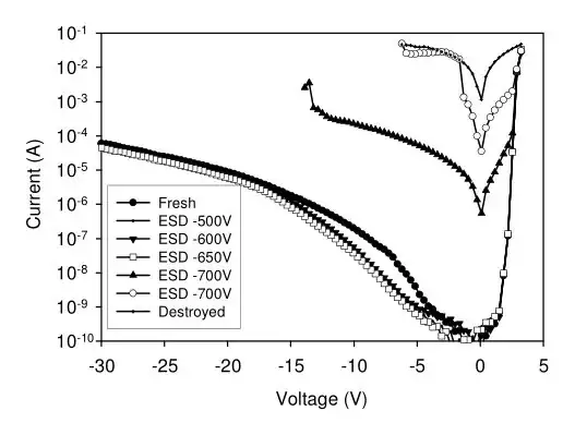

Graph , courtesy of This shows the sensitivity of LEDs in both reverse and forward bias exposed to ESD. Note below, that it is far more sensitive to the left when Vr goes below -5V
(I could write a book on the subject of Partial Discharge(PD) and Breakdown Voltage (BDV) but I'll keep this edit shorter ;)
WHen a PN junction is reverse biased a charge cloud ( like a cumulonimbus cloud) creates a high E-field charge density where defects are mobile charges (contaminant particles) that are accelerated to form a path that will either detonate the particles (by PD) and "wound" the device ( even MVA transformer insulation) or create a streamer path prior to BDV catastrophic event. ( e.g. like lightning but silent)
Except in a reverse biased LED the E-field I am guessing is on the order of magnitude of 5V/um (like 5kV/mm for almost a spark in air. Then molecular impurities with a slightly lower Er constant will have a greater E-field and charge across it than its neighbour. The charge being built up by the > |-10uA| flow of current where White LEDs are spec'd at -5V in small chips.

So to summarize, if a PN junction has a higher tolerance to reverse bias from testing, it does not mean it still is not wounded, just that it has a lower density of particle contaminants in parts per million. The charge acceleration is not linear with contaminant density but rather logarithmic. It is the impact kinetic energy that detonates the micro or nano-sized damage.

research article on Reverse Voltage stress in diodes

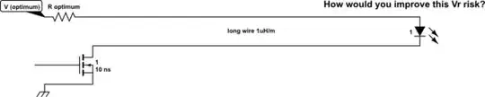

Why is this a bad idea?
schematic

  • Did anyone try the Trivia test with 10ns MOS switch and 1uH /m wire to find the damage threshold – Tony Stewart EE75 Apr 04 '18 at 02:06
