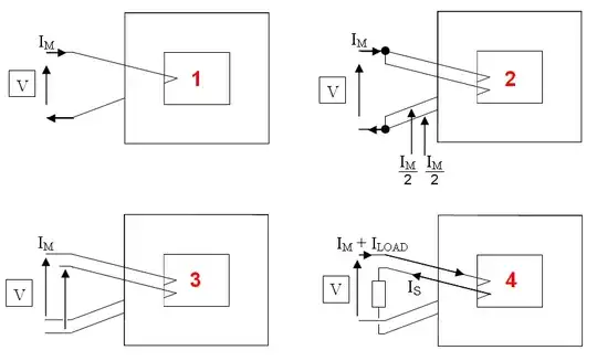

But, an awful lot of enginners don't seem to appreciate that - it sounds unintuitive so how can I convince a disbeliever? Consider the 4 following scenarios: -
Scenario 1 and 2 are about converting a single primary winding into two parallel windings. S1 has a magnetization current of Im and therefore, each winding in S2 takes Im/2. In other words, closely coupled parallel wires behave like a single wire. Interestingly, each wire is S2 MUST now have double the inductance and, if you re-arranged those two wires to be in series you would have a primary inductance that is 4 times that of S1 - this proves that doubling the number of turns quadruples the inductance. Ten times the number of turns means a hundred times the inductance.
S3 asks you to consider what happens when one of S2's paralled windings is disconnected - what would be the phase relationship of the voltage on this disconnected winding compared to the primary winding voltage? If you consider it to be antiphase to the primary voltage then what would have happended in scenario 2 would have created a fire!!
So, clearly the induced voltage in the disconnected winding (S3) is the same phase (and magnitude) as the primary voltage.
S4 should be clear - connect a load to the isolated winding and the current that flows in the primary is in the opposite direction to the current flowing in the "new" secondary.
In short, this means that the ampere turns in the primary (due to secondary load current) ARE totally cancelled-out by the ampere turns in the secondary.
This also means that a transformer that is required to handle a higher load power is not made bigger because of the possibility of core saturation. It is made bigger so that thicker wires (lower copper loss) can be used and thicker wires require more space hence a bigger core.
