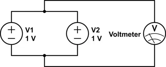

The problem comes when trying to place two 'ideal' voltage sources in parallel. Ideal voltage sources have an internal resistance equal to 0 Ohms.
Let's think about it. These are two ideal voltage sources in parallel:
schematic
The issue isn't obvious yet, but if \$V_1\neq V_2\$, as it is in practice, you have a contradiction.
In other words, if you put a voltmeter across \$V_1\$, is it going to give you the value of \$V_1\$? Or \$V_2\$? The ideal voltage sources enforce a value across the nodes they are placed. So in the previous case, you have two enforcing conditions for the voltage at the same node, which leads to a contradiction if the voltages are not the same.
