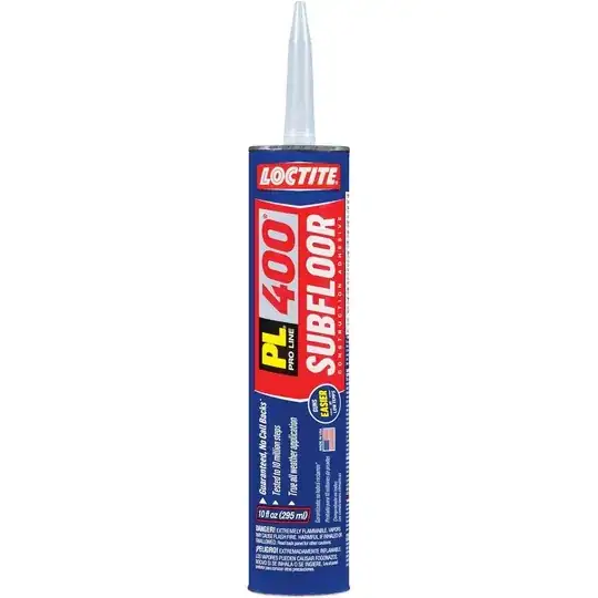

I use PL400 for everthing that needs this kind of strength with a dot and works much better than hotglue which is good for large surfaces but not small wires. Set time is 15 minutes but takes a day to cure and several days for full strength.
Waterproof and weather resistant, great for indoor and outdoor use
Cold weather gun-ability eliminates roll up on wet and frozen lumber
Meets and exceeds APA AFG-01 specs
Gap filling properties help to bridge minor gaps when bond irregular surfaces, reducing squeaking and splitting
High grab formula reduces the use of fasteners
Provides a strong durable bond to multiple surfaces
Low VOC formulation meets stringent State and Federal VOC regulations
Bonds dry, wet, frozen and treated lumber to most building materials
enter image description here They use a white PU industrial version for electronics in power supplies for coils, caps and any large parts for stability.
