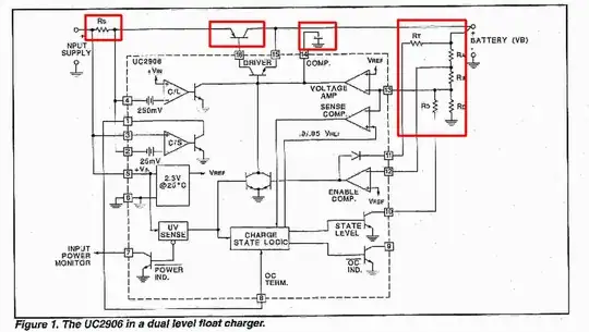

The UC3906 is a very old but still useful lead acid charger IC. Data sheet here. A reasonably capable charger can be made with an IC and a handful of parts. See datasheet fig 1 for details re this circuit. In this example 6 resistors, a capacitor and an external pass transistor are all that need to be added to make a dual level float charger with far more "intelligence" than is available in the simple LM317 based chargers. The data sheet and related application notes provide enough explanation to allow microcontroller based algorithms to be derived to mimic and improve on the functions of this IC.
enter image description here About $7/1 from Digikey.
