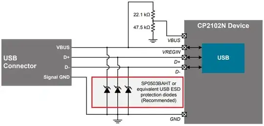

I have been wanting to update a design I have to include a USB to UART Bridge and while looking at the datasheet for the CP2102N saw what is in the image below. I have never worked with a TVS before so I am not entirely familiar with their specifications.
When the datasheet says to use "SP0503BAHT or equivalent USB ESD protection diodes (Recommended)" what exactly determines a TVS is 'equivalent' or 'better'?
While searching around I came across this post which has the TI TPD4S012 listed as a suitable USB TVS. I'm not looking for someone to verify that the TPD4S012 is a suitable replacement for the SP0503BAHT, rather, the understanding of what to consider when choosing.

If you look at a parametric search for TVS diodes, you will see columns of the parameters that differentiate the diodes.
The most important are breakdown and clamping voltage, peak pulse power/current, and whether the device is bidirectional. Bidirectional diodes are back to back diodes so that they can clamp both positive and negative voltages. For high speed digital lines, the capacitance is also very important, since high capacitance will attenuate your digital signals.
If you choose a diode with similar breakdown/clamping voltages, peak pulse power/current, "bi-directionality", and capacitance, you should be OK.

Besides voltage and single or bidirectional the important parameters are the conductance or ESR and the capacitance .
the product of the two would be your figure of merit. The trade off Is that when ESR is reduced capacitance normally increases and capacitive loading the limit signal slew rate.
Because of the many variations , major distributors have search filters by application. From there choose the best bang for the buck.
Although many TVS diodes are rated for the induced lightning test 10/120 µs , this may be irrelevant for ESD protection where rise times on open cable contact can be sub-nanosecond
