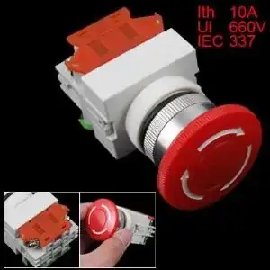

It is named "Mushroom Emergency Stop Button Switch". Or just EMO button. enter image description here
  • I've seen those, and while cool they don't do quite what I'm looking for. I need a switch that works as a typical momentary pushbutton, but can be twisted to lock it in the off position. – Grant Jul 20 '12 at 14:23
