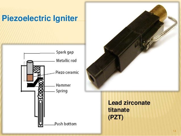

The YouTube video explanation was technically incorrect and was finessed carefully with a precision gap to strike an arc, avoid shutdown, sustain an arc and adjust the gap to sustain a bigger arc to raise the temperature to red hot levels of burning air.
It was not simply voltage that caused the fire. If it were simply voltage, we would never be driving in 12V cars.
Rather it was a (carefully) shorted (point contact) circuit current and arc of sustained high energy density below an example of a primitive converter protection threshold.
The same might be possible with an inductor from a 1.5V D cell battery or a single LiPo cell with needle electrodes. The battery may also overheat and explode. Products shipped with batteries are required to have plastic sleeves to insulate the battery terminal from exposure of the product wires being crushed during shipping.
So it was not the voltage that posed the risk, rather the resonant arc of voltage & reduced current with a plasma arc load near the source impedance of the battery for maximal power transfer, sustained for a time duration to raise the plasma temperature to 3000'K red hot not 10000K .
